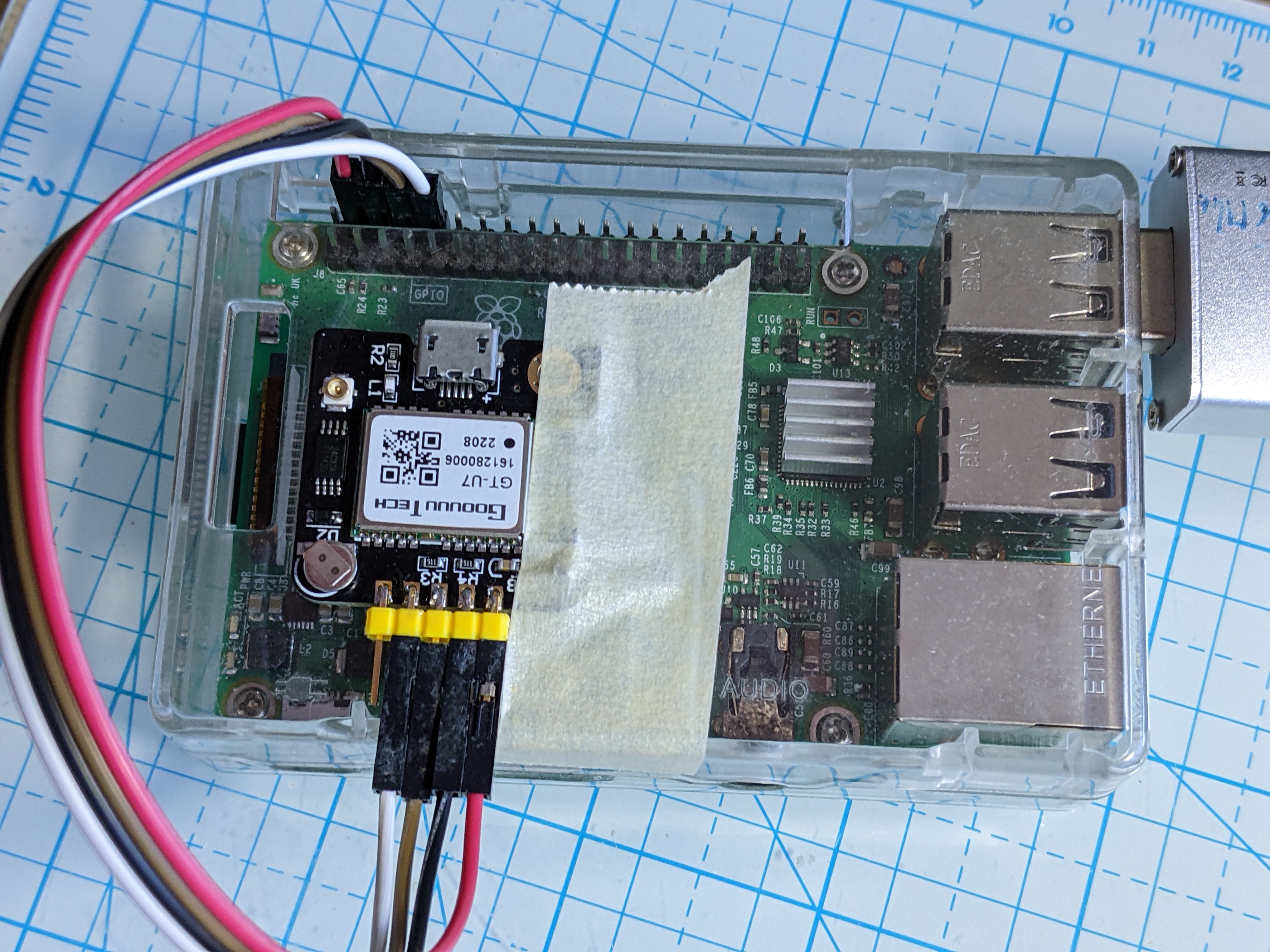

You can also connect via serial using 4 jumper wires. You will need to connect to the Raspberry Pi's GND, 5V, Uart-TX/gpio14, and Uart-RX/gpio15. Search for "raspberry pinout" and you will find many pictures that show the rPi connector pin assignment. The 4 pins you need to connect to are all next to each other on the outer row. Note that TX on the rPi goes to RX on the GPS module and RX on the rPi to TX on the GPS. In addition, if the GPS provides a PPS pin (Pulse Per Second) it can be connected to pin 7 / GPIO4.

In the US, the author has been successful with 2 purchases of the following GPS module available on Amazon: <https://www.amazon.com/gp/product/B07P8YMVNT> and the serial connection looks something like this (please use pinout diagrams! and oops, should have connected the PPS pin as well...):
<figure><img src="/files/Bmy4lHMXvuXUxGoLAaVI" alt=""><figcaption><p>GPS connected to rPi3 using serial cable for illustration (this is not a permanent install...)</p></figcaption></figure>
