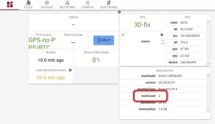

## Updating the boot number
### What is the boot number? <a href="#what-is-the-boot-number" id="what-is-the-boot-number"></a>
The boot number is an incremental marker of how many times a SG has rebooted. It is represented in the file name as well as the web interface in the V2 SensorGnome.
<figure><img src="https://docs.motus.org/~gitbook/image?url=https%3A%2F%2F2642021313-files.gitbook.io%2F%7E%2Ffiles%2Fv0%2Fb%2Fgitbook-x-prod.appspot.com%2Fo%2Fspaces%252FGrf8Wg5oUFTJbWHxHdF7%252Fuploads%252FIjBEAMxz01yJwShYnfKj%252F2025-01-22_112412.png%3Falt%3Dmedia%26token%3Dd37b489b-1ce5-4824-9914-9433af9ea1cd&#x26;width=768&#x26;dpr=4&#x26;quality=100&#x26;sign=42063987&#x26;sv=2" alt=""><figcaption><p>The current boot number displayed in the V2 SG web interface</p></figcaption></figure>
<figure><img src="https://docs.motus.org/~gitbook/image?url=https%3A%2F%2F2642021313-files.gitbook.io%2F%7E%2Ffiles%2Fv0%2Fb%2Fgitbook-x-prod.appspot.com%2Fo%2Fspaces%252FGrf8Wg5oUFTJbWHxHdF7%252Fuploads%252FynjelAHd1hj8qke1XhsS%252F2025-01-22_115538.png%3Falt%3Dmedia%26token%3D01992b43-3968-4c30-9e6e-f39bb1db4d13&#x26;width=768&#x26;dpr=4&#x26;quality=100&#x26;sign=fb782d40&#x26;sv=2" alt=""><figcaption><p>The boot number is embedded in the detection data file name (on both V1 and V2 SG)</p></figcaption></figure>
The boot number is an essential component when processing detection data as it can account for bad timestamps (when the GPS reports an incorrect date/time) and for stringing together long detection runs that overlap multiple uploaded batches. Because the `tagfinder` algorithm works under the assumption that the boot number *always* increments, issues can arise when the boot number is reset.

1. **Before updating the software**, connect to the SensorGnome and visit the web interface. From the landing page, you should be able to see the current boot number (as the screenshot above shows). Write this number down or otherwise commit it to memory.
2. After you have upgraded and initiated the new software, connect to the SG and navigate to the "Software" tab to update the boot number. Recalling the previous value, set the new number higher higher than necessary then reboot the SG and confirm that the change has persisted when you connect again.&#x20;
3. Reboot the SG and connect to it to confirm that the change is persistent.
