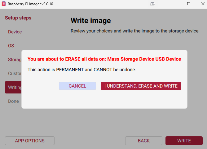

Click WRITE and then click confirm on the warning dialog
6
Wait for the process to complete
There is both a writing and verification stage and together the entire process can take 10-15 minutes.
