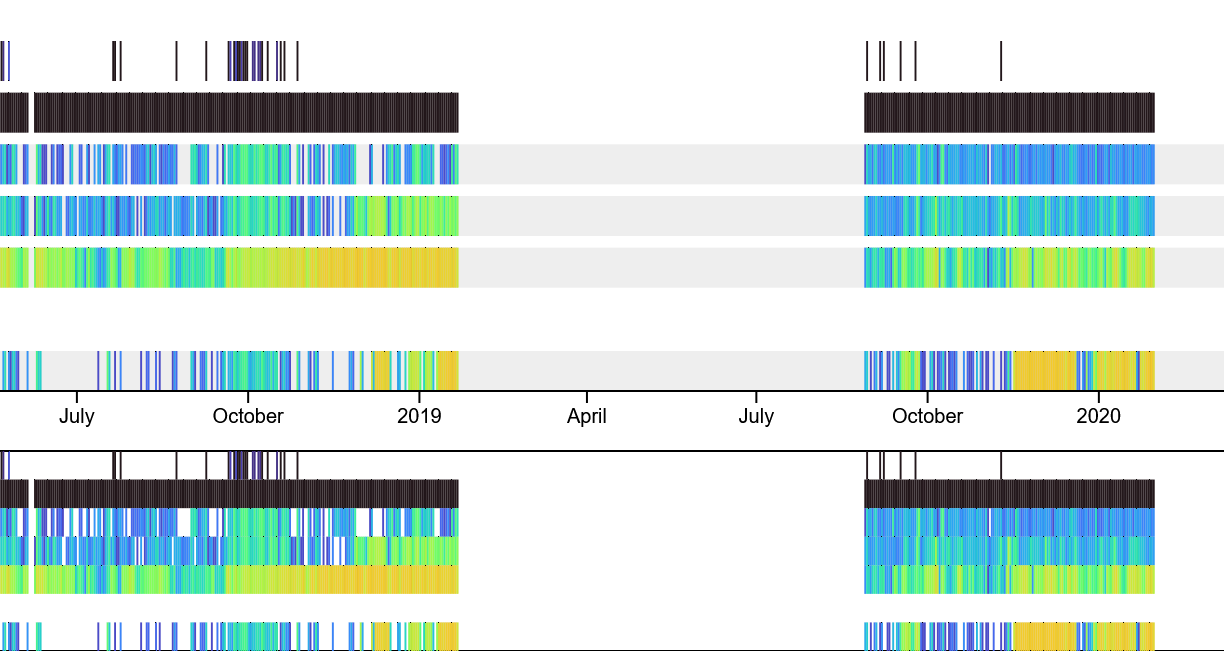

* Checking for station functionality over time essentially means looking for gaps in the data, but that will only be possible in cases where data are collected consistently enough like in the example below.&#x20;
<figure><img src="https://2565212148-files.gitbook.io/~/files/v0/b/gitbook-x-prod.appspot.com/o/spaces%2Fjf0K5m6GrB75xw7Xweac%2Fuploads%2FiCn4gLBHxh4LhmRhj4FX%2Fimage.png?alt=media&amp;token=488df8fd-92ba-4006-85ee-7458e9257ce4" alt=""><figcaption><p>Example data gap</p></figcaption></figure>
