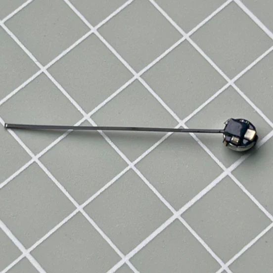

|                                       | [**Lotek Nanotag** ![Lotek Nanotag](https://2565212148-files.gitbook.io/~/files/v0/b/gitbook-x-prod.appspot.com/o/spaces%2Fjf0K5m6GrB75xw7Xweac%2Fuploads%2Fgit-blob-eec1051a40864fc27767f01bf1dec7e06c927a0b%2Flotek-nanotag.jpg?alt=media)](https://www.lotek.com/products/nanotags/) | [**Lotek Nanotag Solar** ![Lotek Nanotag Solar](https://2565212148-files.gitbook.io/~/files/v0/b/gitbook-x-prod.appspot.com/o/spaces%2Fjf0K5m6GrB75xw7Xweac%2Fuploads%2Fgit-blob-7dfd57d6316b1c65a562655da78b2ab76c7e87b7%2Flotek-nanotag-solar.jpg?alt=media)](https://www.lotek.com/products/solar-nanotags-coded-vhf-for-birds/) |
| **Manufacturer**                      | **Lotek**                                                                                                                                                                                                                                                                               | **Lotek**                                                                                                                                                                                                                                                                                                                           |
| Frequency                             | 150.1, 151.5, or 166.380 MHz                                                                                                                                                                                                                                                            | 150.1, 151.5, or 166.38 MHz                                                                                                                                                                                                                                                                                                         |
| Lifespan                              | Long (20 – 2000 d)                                                                                                                                                                                                                                                                      | Unlimited                                                                                                                                                                                                                                                                                                                           |
| Daily active period                   | 24/7 or alternate 12-hour on/off                                                                                                                                                                                                                                                        | 24/7 (battery and solar powered)                                                                                                                                                                                                                                                                                                    |
| Weight                                | 0.15 g – 3.00 g                                                                                                                                                                                                                                                                         | 1.4 g and up                                                                                                                                                                                                                                                                                                                        |
| Smallest bird (%3 body weight)        | 5.0 g                                                                                                                                                                                                                                                                                   | 46.7 g                                                                                                                                                                                                                                                                                                                              |
| Possible number of unique tags        | >36,000\*                                                                                                                                                                                                                                                                               | >36,000\*                                                                                                                                                                                                                                                                                                                           |
| Burst intervals                       | \~2-40 seconds                                                                                                                                                                                                                                                                          | Similar to CTT (may diminish with power loss) \[needs more information]                                                                                                                                                                                                                                                             |
| Compatible with CTT Receivers         | SensorStation with FUNcube Dongle only                                                                                                                                                                                                                                                  | SensorStation with FUNcube Dongle only                                                                                                                                                                                                                                                                                              |
| Compatible with Lotek Receivers       | Yes                                                                                                                                                                                                                                                                                     | Yes                                                                                                                                                                                                                                                                                                                                 |
| Compatible with SensorGnome Receivers | With FUNcube dongle only                                                                                                                                                                                                                                                                | With FUNcube dongle only                                                                                                                                                                                                                                                                                                            |
| Price                                 | \~$200 USD                                                                                                                                                                                                                                                                              | \~$200 USD                                                                                                                                                                                                                                                                                                                          |
| Discount                              | Contact Lotek                                                                                                                                                                                                                                                                           | Contact Lotek                                                                                                                                                                                                                                                                                                                       |
**\* This number is calculated by multiplying the number of unique ID’s emitted by Lotek tags (517) with the number of unique burst intervals available (70). These burst intervals range from 2.3 to 39.7 seconds, which corresponds to the number of primes between 23 and 397 such that no two burst intervals overlap with one another.**<br>
